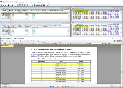

lukaszadrapa
I did quick test to be absolutely sure there's no HW issue and it works as expected. The behavior of the MCU corresponds to the documentation. I placed one boot header at 0xFC0000 and second to 0xFA0000 and I can see that 0xFC0000 is used after reset:
If this doesn't work, check the boot headers. There's probably something wrong in your project.
Then I saw some mention about Rappid bootloader in your description. Notice that Rappid bootloader does not use the order defined in RM to search valid boot header. It simply search from lowest address of a block to highest:
