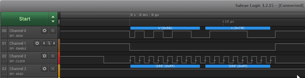

I give up. No matter what I try to do, I just can't seem to drive chip select low.
I can see the SPI_CLK and SPI_SOUT signals and they look perfect.
I know the pin is working. I used it as a gpio.
(The SPI is configured as a master. There are no reply messages, just an LCD screen)

That's the example I took from.
The problem is that there is no 'other chip' to select.
It took me a while to figure out that I had to clear the status flags before or after a transmission, still not sure which.
I'm not sure what I am doing wrong. If the example CS is supposed to work correctly, then It has to be on my end.
I was hoping that maybe somebody would say 'oh yeah, you have to..."

yes, the example from the AN is working. To be sure, I did quick test on my board - I just checked the master signals, I did not connect it to slave. The chip select is working as expected.
Before writing data to PUSH register, you should check if the buffer is not full (TFFF flag).
When reading data, you should check if the data are already received (RFDF flag).
After reading of received data, clear flags TCF, RDRF and EOQ (if used). Also an error flags can be set - overflow or underflow.
