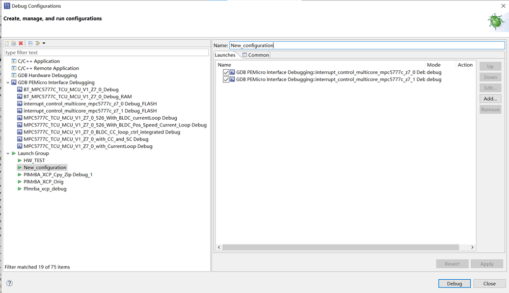

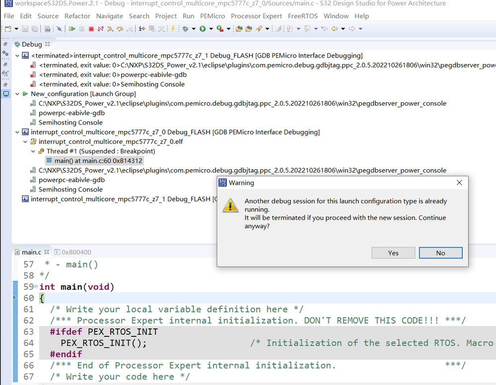

I want to ask a question about how to use the example of MPC5777C  which provided by NXP.I opened the demo project which is called:
"interrupt_control_multicore_mpc5777c_group Interrupt control multicore mpc5777c"

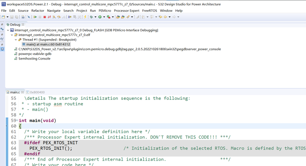

I finished compling and flashing the reprogramming to a control board.Howerer,i found that only core 0  was running and the core 1 cannot be displayed when debuging.This case is abnormal and maybe some palce is not set correctly.
I captured the picture as the following,who can tell me where is the key reason of the problem?

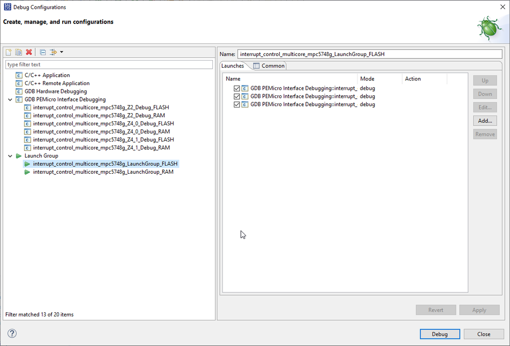

jiri_kral

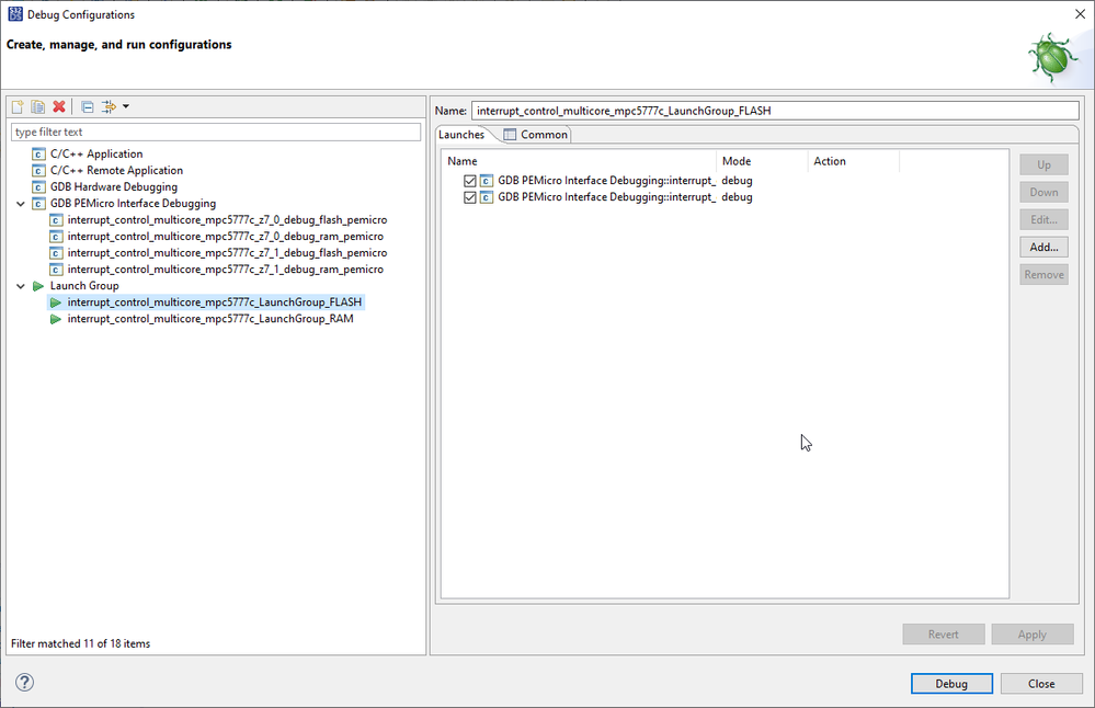

for multicore debug you need to start Launch Group which is part of Example:
If you already modified the launch group - the easiest way how to fix it is delete old example from workspace and create the project again.

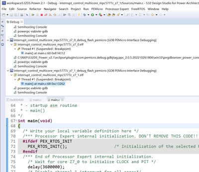

Harry0001
Thanks for this answer,i deleted the old project and builded a new example again,then it worked well.Other settings seems to be not necessary at all,and the most important thing is to creat a startup group and debug it.

Harry0001
What you show on the picture has three debuging for the Launch Group,it is a three cores MCU example?What i used is a two cores MCU and i had added both the two core debuging item into the launch group,just like my picture showing,but when flashing it only shows core 0 running.I do not know why core 1 not run.So, i need to know whether there is still some other settings about two cores running.
2,895 Views

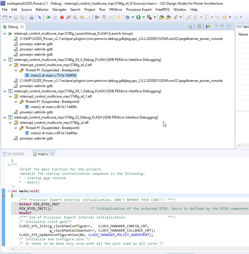

jiri_kral
I had MPC5748G board on my desk, So I used example for it. The example for MPC5777C is the almost the same. You need to select launch group which belongs to the example:

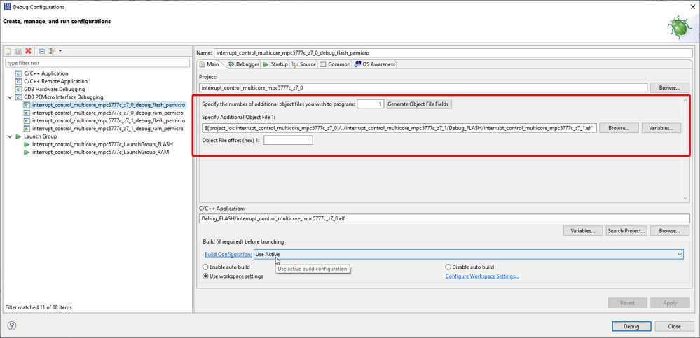

If you are creating new launch group, make sure that for boot core is added additional .elf file from second core:

Harry0001
Thank you for your reply!
I tried your method,however,when debug the launch group,core 0 start running,then a pop-up window appeared as the following.when chose yes,core 0 will close,then core 1 start running.It is strange for the pop-up window.
