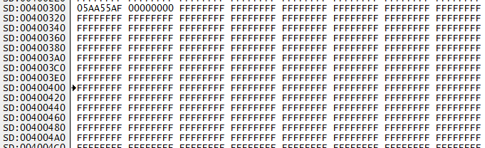

Dear All,
I develop with MPC5777C and ETAS RTA OS.
Chip S/N : SPC5777CCMME3  3N45H CTFA1624A
Also I implemented MCAL RTM Version for our application.
I want to configure STCU and get a BIST result. But STCU2 module looks has some problem.
Most test results are failed or not yet completed..
As I know, STCU off line test is executed automaticallly,, So It doesn't need that related Source code..
Also Refer to my UTEST area, STCU RUN is Enabled.(Set Default Value)
I don't know why do this...
Please give me advice and solution.

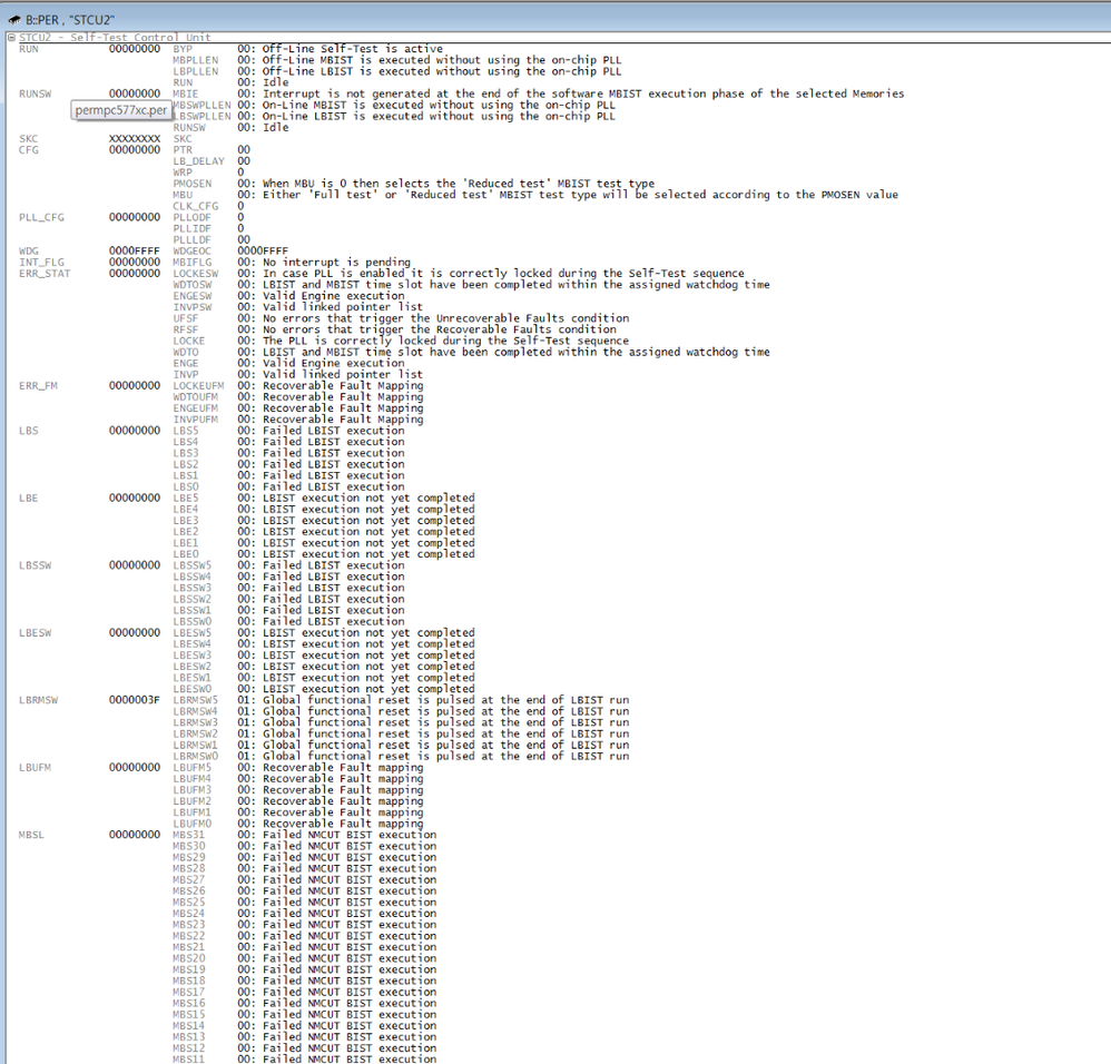

petervlna
As you can see from STCU2 module your off-line BIST is not configured. LBIST and MBIST control registers must be configured in order to perform test successfully.
For off-line BIST configuration must be done via DCF records.
To get an good overview on this problematic I suggest you to read AN5131:
http://cache.nxp.com/files/microcontrollers/doc/app_note/AN5131.pdf?fsrch=1&sr=2&pageNum=1
