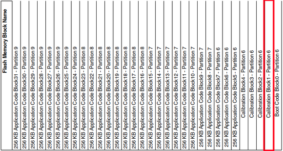

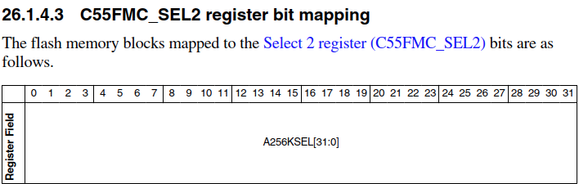

Please find the attached file of flash program source code for MPC5777C as per the example code. After executing this code i found that block 30 address locations are getting updated as per the data mentioned in code but again if i want to modify the content of the same address locations i am not able to update it with new data and it is found in disabled state
2,148 Views
davidtosenovjan
Hi, following line does not fit to the the block 30:
C55FMC.SEL2.R = 0x00000002; // select 30 block
