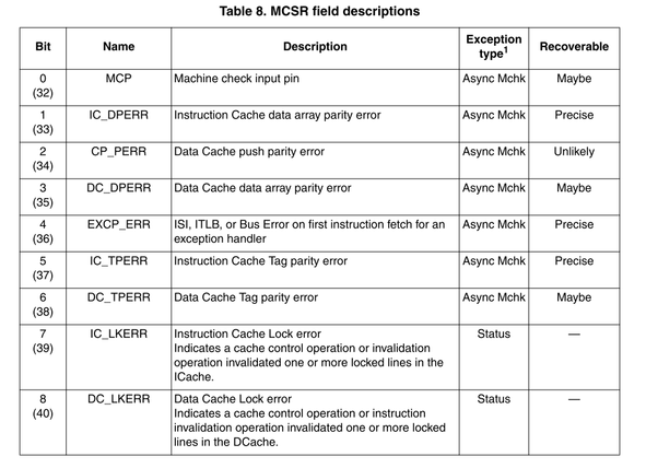

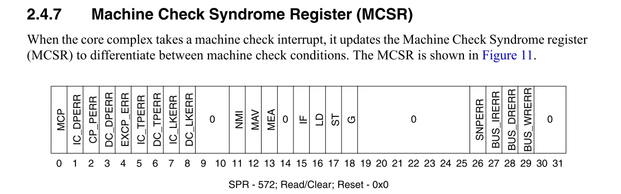

If you see IVOR1, then check the details of the exception in MSCR register
I do not see this issue linked to FCCU, Rather some access restriction.
Identify the reason for IVOR1 then you will see where to look.

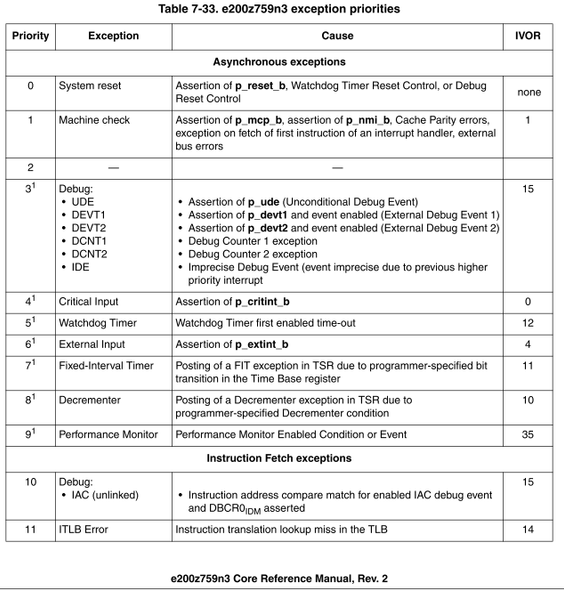

Which kind of exception you are getting? IVORxx number?
I would like to know if it is normal for an Exception to occur during initialization.
Exception is never normal state. It means you have some issues in access, etc...
Please refer to the core reference manual for details:
7.8 Exception recognition and priorities
