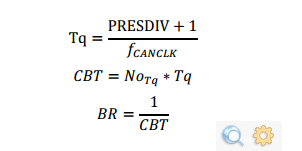

I want to test the CANFD with 4 MBPS so ... I did the calculations using this algorithms by keeping PRESDIV to 0 and I got the N0Tq as 10. And I kept the initialzation as below

I have a further question. How to configure the data rate to 3Mbps..
I tried calculating this formulas.. But its not working for me..
I would really appreciate if you can help me on this. to initlaize my Data rate registers.

Hi Akshay,
from the formulas, you gave, you can get
(PRESDIV+1) * NoTq = fCANCLK / BR
Then assuming PRESDIV and NoTq are integer values only, there is no possible setting for given PE clock and baudrate.
Different PE clock has to be used.
BR, Petr
