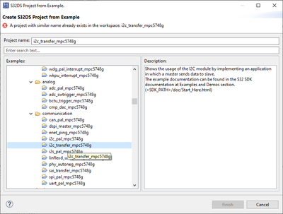

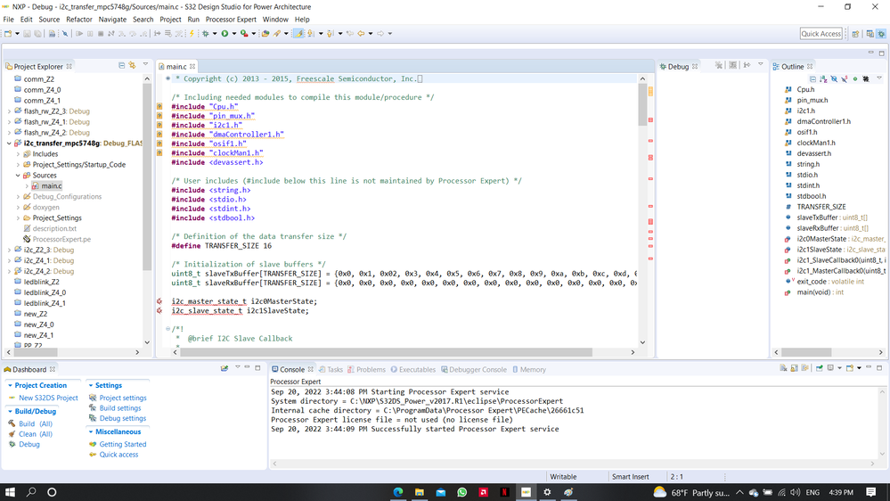

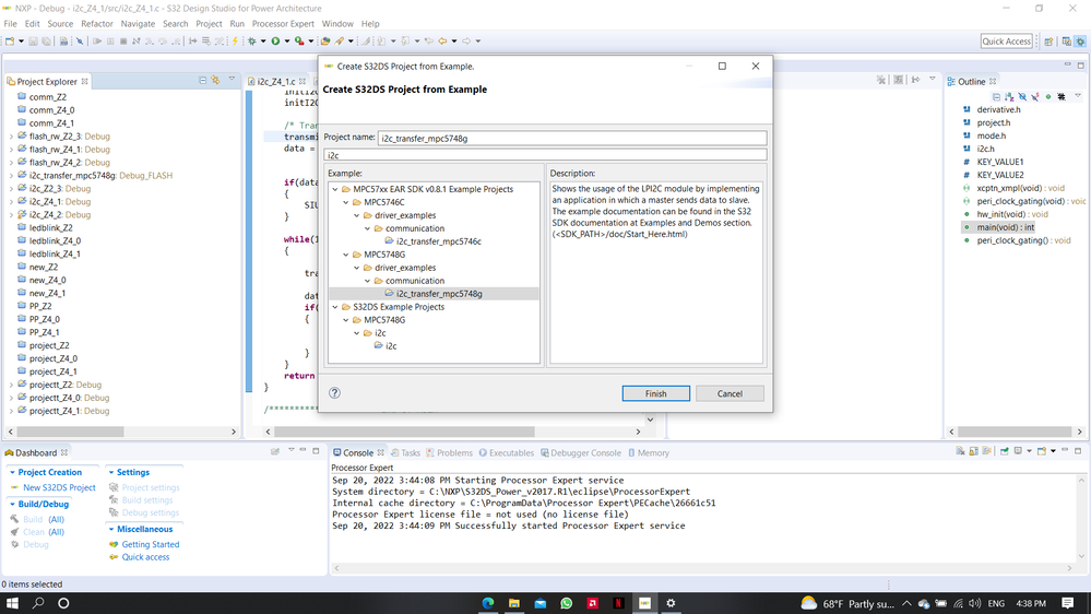

turkmani_11
oppening it from s32ds project from example doesnt give me the whole include and src files, how can i get them all?
can you explain how can i open it so i can try to debug it?Untitled 2.pngUntitled 2.pngUntitled.pngUntitled.png
as you can see i cant work, many errors because other files are not loaded, please help me by telling me how to open the example project

PetrS
try to generate PE code, e.g. through menu Project -> Generate Processor Expert Code
Then build again.
However seems you are using older S32DS and SDK. Try to use latest one S32DS 2.1 and S32_SDK_S32PA_RTM_3.0.3.
