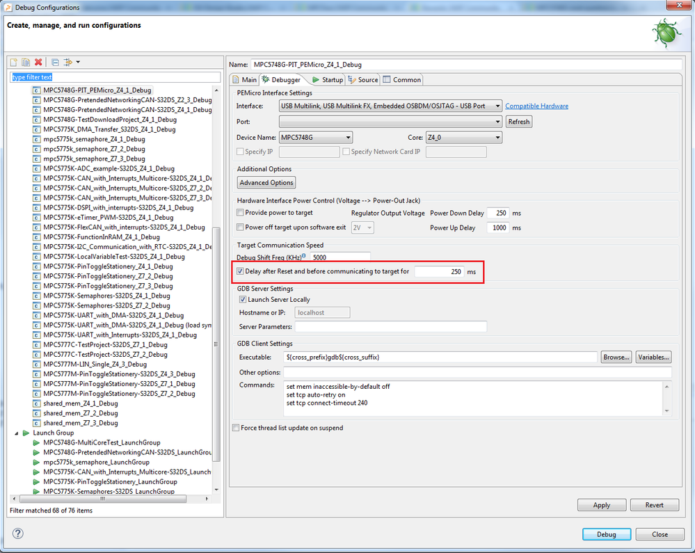

When I was downloading program for MPC5748G, the power was cut off accidently. Now the MCU reset pin is always low level, and I can't download program anymore. The S32 design studio shows the window below:
Has the MCU been locked? What should I do to have access to MCU again?

martin_kovar
Hi qiaodeng​,
have you correctly configured Delay after reset in debug configuration? Recommended value is 250ms, but you can use longer time.
Martin
5,261 Views
qiaodeng
Hi Martin,
I have configured the delay time as 1000ms, but it still doesn't work. Because the reset pin is always at low level, I think the chip may enter some kind of reset mode?

martin_kovar
Hi Qiao,
yes, it seems it is the same problem which Bernhard had. Are you able to try it again with different microcontroller? Because when reset line is always low, it most probably indicates the micro is "dead".
