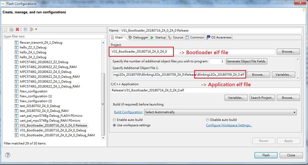

I got a bootloader, and application, try to jump from bootloader/main() to application.
What jumping address is correct?
Here is detail configuration of my test environment:
My bootloader:
MEMORY
flash_rchw : org = 0x00FA0000, len = 0x4
cpu0_reset_vec : org = 0x00FA0000+0x10, len = 0x4
cpu1_reset_vec : org = 0x00FA0000+0x14, len = 0x4
cpu2_reset_vec : org = 0x00FA0000+0x04, len = 0x4
m_text : org = 0x1000000, len = 1024K
m_vectors_ram : org = 0x40000000, len = 0xC00
m_data : org = (0x40000000+0xC00), len = 768K-0xC00
My application:
MEMORY
flash_rchw : org = 0x00FA4000, len = 0x4
cpu0_reset_vec : org = 0x00FA4000+0x10, len = 0x4
cpu1_reset_vec : org = 0x00FA4000+0x14, len = 0x4
cpu2_reset_vec : org = 0x00FA4000+0x04, len = 0x4
m_text : org = 0x1100000, len = 2048K
Then I flash both ELF file into flash like this
Now I add jump funciton in bootloader's main() as below:
//Jump to Flash/boot header : 0x00F04000
asm("e_lis %r12,0x00FA");
asm("e_or2i %r12,0x4000");
asm("mtlr %r12");
asm("se_blrl");
Why it does not work? Is jumping address 0x00FA4000 wrong?

Why it does not work? Is jumping address 0x00FA4000 wrong? Yes. There is only 005A there, not the programs code.
The Bootloader elf file you have in the pic is the project name. It even says "Project".
