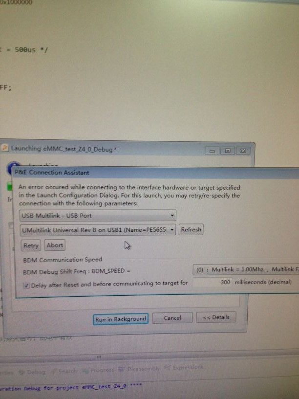

      I'm using PE to debugg  MPC5748G project ,but there is problem in progress,177546_177546.jpg11.jpg177547_177547.jpg1.jpg
 I powed down and powed up the power, pressed  'OK' in the first picture, but there is the other problem in the second
picture. I pressed  'Retry ' ,and   the first problem appeared again.......
How to solve theses problems?

did not you accidentally turn off the power supply or push reset button during the downloading your code to the microcontroller?
Have you correctly installed and updated PEMicro drivers?

Hi, Martin Kovar
 The hardware hasn't  push reset button,and  I didn't  turn off power when downloading code.
  I  guess the mcu has been secured ,and how to unsure the mcu  for S32 IDE?
  Or is there any problems?How to solve it?

Hello Tom,
if you use only S32 Design Studio, it is nearly impossible to secure the device. S32DS does not modify UTEST flash area.
At first, check you have correctly installed and update PEMicro drivers.
Which debug probe you use?
If you use Multilink Universal or Multilink Universal FX, please disconnect jumper J5 in debug probe.
Which version of S32DS you use? version 1.0 or 1.1?
What is your microcontroller mask?
Did you try to use another microcontroller?
