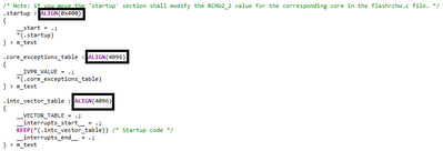

Hello.
I need to minimize '.bin' file.
So I remove those ALIGNs in Linker File.
But I worry the reason of those ALIGNS.
Is those ALIGNs necessary?
if so, why necessary?
Best Regards
Phillip

I dont think startup code needs to be aligned.
But exception and INTC vector table must be aligned. For more details please see core reference manual.
