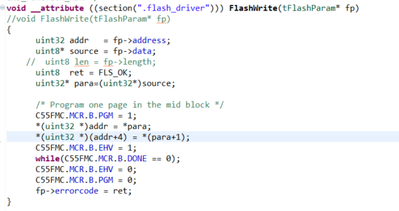

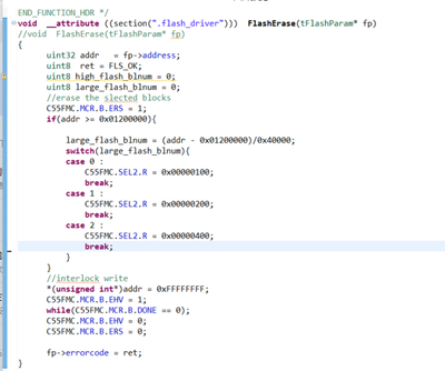

HI All,
I  code the Flashdriver to write APP data to address:0x01200000 to 0x01280000. I write the flashdriver
code to ram address, then Bootloader use it to erase and write data.
But when I test the code , I found it that it has a problem:
0x01200000 ~ 0x0123FFFF , it could write data successfully.
0x01240000 ~ 0x0127FFFF, it could write data successfully.
0x01280000 ~ 0x012BFFFF, it could write data fail.
Then I change some methods to test it, I put the flashdrvier code to Bootloader without ram,but Block 0x01280000 write fail all the same.
Then I test another way, set the breakpoint when it is programing the data to flash 0x01280000 address .
I debug it , it could write the data by step over , but when I run it  without breakpoint, it will fail to write data to only Block 0x01280000.
Then I change  the block address,  three blocks , it will fail at the third one.
I  reference the flashdriver code about MPC5748G-Flash_RW-GHS614_v1-1, why it will cause the
problem when  I operate three flash addresses continuously?
I put the code it out, can anyone tell me how to solve it ?

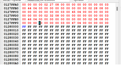

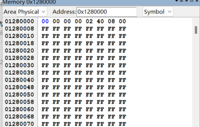

Ada_Lovelace
HI,Lukas
1. I do not use interrupt in the Bootloader. I try to put the flashdriver code in the bootloader (not in RAM), the third block do not write data. It's 0xFF.
2. I do not enable CACHE, it will not cause IVOR1 triggered. I want to write the three block's data into the
addree, but only the third block has problem, the data is not expected, it's all 0xFF.
But when I debug the code , the third block can be write the expected data into the address by the breakpoint. It means I can write the third block by the step over. But It's 0xff when I run the project without breakpoint. You can see the image.
I do not understand why it will cause the problem like this, what should I check to solve it ?
