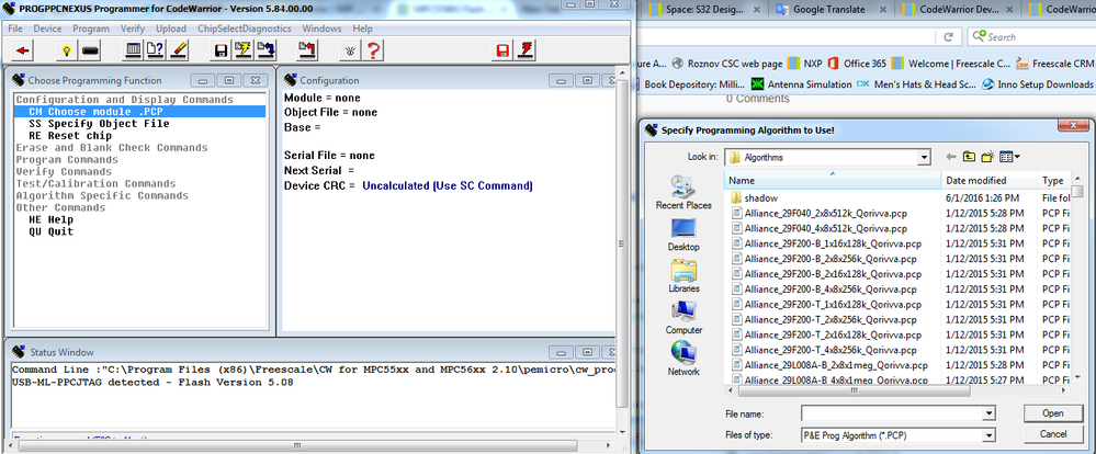

Download and install CodeWarrior
http://cache.nxp.com/lgfiles/devsuites/PowerPC/CW55xx_v2_10_SE.exe
Download this patch and update the CodeWarrior according to Readme.txt file
http://www.pemicro.com/faqs/faq_view.cfm?id=211
Run cw_progppcnexus.exe and click connect.
Popup window with reset escalation information appears. Do power on reset (switch board off and on and click OK).
After that, window with choosing algorithm appears. Click cancel.
Now double click Reset chip.
Popup window with reset escalation information appears again. Do power on reset and click OK. Now you should be able to connect via PeMicro until next power on reset.

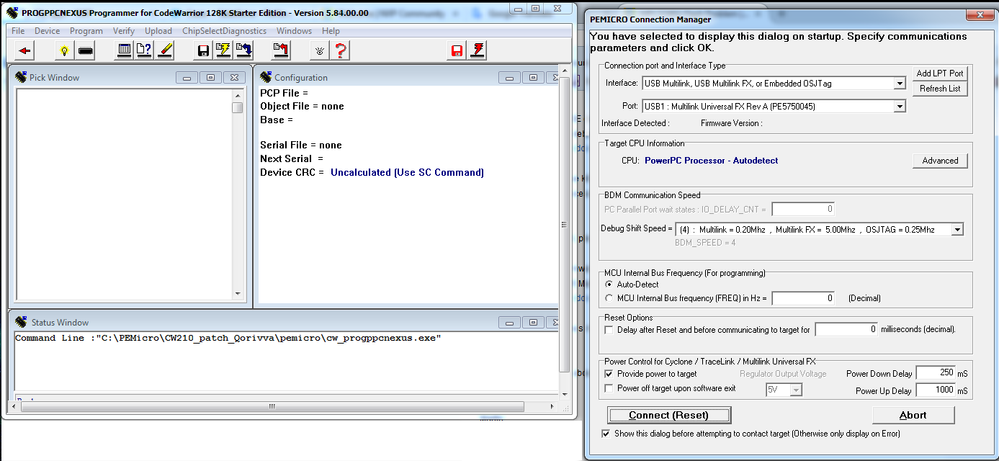

bdn
Hi Martin,
I downloaded and installed the patch CW210_patch_Qorivva.zip.
I'm using S32DS and there are none of the mentioned processes running.
The PE Micro USB Multilink Universal FX has the latest firmware 9.40 on it. cw_progppcnexus detects that.
Thank you and regards
12,240 Views

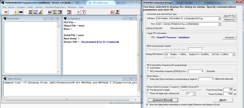

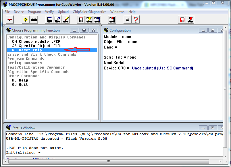

martin_kovar
could you please send the following screen from your side?
Martin
12,240 Views

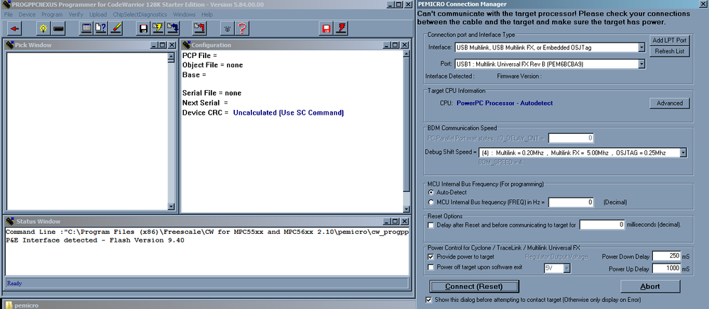

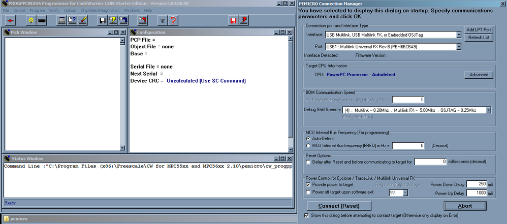

bdn
When I start cw_progppcnexus:
And after Connect and power cycle:
When I click on Reset, the yellow LED lights two times but the red one (from MCU) stays red all the time. So I think the MCU doesn't recognize the reset from PE Micro.
In S32DS I had to set up a Delay after Reset and before communication but this didn't help here.
12,240 Views

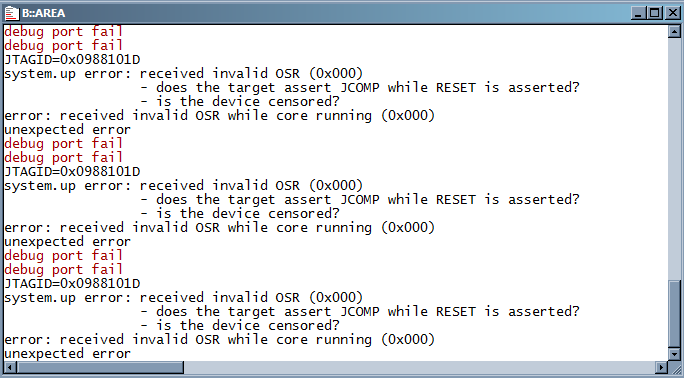

bdn
Hi Martin,
here's the screen:
What does OSR and JCOMP mean?
Bernhard
