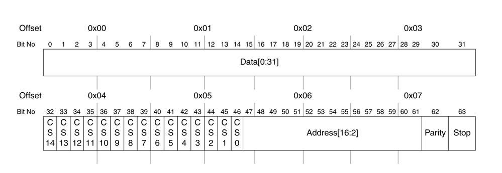

This is quite simple and it is described in reference manual chapter 11. DCF records.
Few steps:
1. Construct the DCF record you like to program (according to chapter 11.3 DCF record structure)
2. simply program it to first free location in your UTEST DCF user records area. This area starts with DCF start record.
You can program it from code or via debugger (this is up to you). I recommend you to write debugger script for DCF records programming. Especially for HSM records.
3. restart the device
That's all.

Hi Peter,
For SPC5748ghmku6 (MPC5748G).
I know how to program the DCF record and also I know how to get the first available address of the DCF (Using the Stop bit as mentioned in the reference manual).
i.e 0x00400638 is the first available address in my case, and I should write 8 bytes from the mentioned address in order to enable the HSM.
Kindly please send us directly those 8bytes to enable the HSM for (SPC5748ghmku6)
Would be perfect if you please describe how to calculate the CS, Address and Data for HSM enable only.
Please keep in mind that I have the Security Reference Manual and SHE on MPC documents there fore please dont hesitate to point to a page in you description.
Thanks in advance and have a nice day.

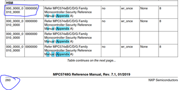

yashkhatri0291
"0x00400370", how do you find this first free available address?

yashkhatri0291
This is what my memory at the given address looks like, please tell me how and where I can write my HSM enable DCF client::
10,321 Views
petervlna
Program your DCF records for HSM enable at address 0x400380.
0xFFFF_FFFF means stop record. No record after this pattern is processed.

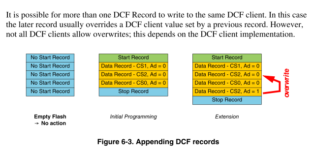

petervlna
How do you update the DCF record?
Simply add new DCF record in first available space in UTEST memory. SSCM module will take in account the last valid (of same record) DCF record found in memory.
