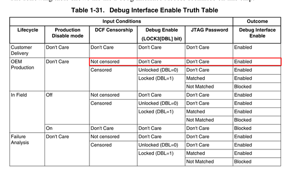

Issue 1:
I lock Jtag by function void debug_lock() as bellow, then how can I unlock the jtag by any other function?
Issue 2:
Lauterbach can attach MPC5746R by  sys.option.KEYCODE,but can not program flash,  could anyone give me a example?

Issue 1:
Not sure what is debug_lock(); But to uncensor the device you will simply add DCF record for 0x55AA to censorship DCF.
Issue 2:
hmm, this is strange. Are you performing the reset in your programming script? Some devices had issue with loosing the key when reset was performed.
Try this script. I have removed reset from it.
Further refer to the PASS AN to see how censorship works. It is same for this device.
https://www.nxp.com/docs/en/application-note/AN12092.pdf
Peter

run this script, Lauterbach shows "FLASH erase error"

Your script is not able to start erase. This is usually because of incorrect flash initialization for debugger.
Check your flash.list to see if the blocks are correctly initialized and if they are not protected for writes.
 You can also use the script embedded in Lauterbach for device erase. You will fin dit in the TAB drop down menu MPC5xxx.
But generally in case of issues with third party tool usage we recommend to contact Lauterbach support.
Attached is mine simple script for flash erase of MPC5746R device.
