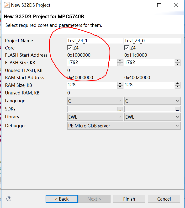

  I am debugging MPC5746R with S32 Studio. I can only debug z4_1 successfully. If I flash z4_0, it will show the error:
Error in ONCE status register during instruction execution.
  Also I am confused about the project name when I create a new project:
According to the start address, it seems that the project Test_Z4_1 corresponds to the core Z4_0, and the name can't be changed. Could somebody explain this ?
Qiao

Z4_0 is the core, which MPC5746R boot from. It does not matter which address you use for Z4_0 and Z4_1.
I tried to load core for both cores via LaunchGroup and it works correct. I also tried to load code for Z4_0 and it works correct,
It not possible to debug Z4_1 without Z4_0. Z4_0 project loads code for both cores and Z4_1 only attach itself.
