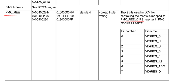

Hello community,
I have a question regarding to the DCF records of OTP memory sections
The attached image is for a memory section part of DCF records.
I wonder where the OTP records is located
At which address, I can find these records.
Thank you.

DCF records are located in UTEST memory starting at 0x400200.
If you are asking in which registers the DCF records are copied to during the reset. There can be multiple registers and all of the are always described in reference manual. For example:

I'm asking about the address of the otp_high DCF record
1,468 Views
petervlna
You can find it in reference manual. There is no memory mapped register.
