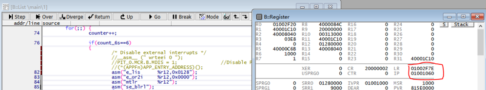

qiaodeng
Hi Peter,
     My application locates at 0x01280000,
MEMORY
flash_rchw : org = 0x00FA0000, len = 0x4
cpu0_reset_vec : org = 0x00FA0000+0x10, len = 0x4
cpu1_reset_vec : org = 0x00FA0000+0x14, len = 0x4
m_text : org = 0x01280000, len = 1024K
m_data : org = 0x40000000, len = 128K
In the bootloader, I wrote the following code to jump to the application, but during the jump it reports  "No source available for "IVOR1_Vector() at 0x1001010" .
asm("e_lis %r12,0x0128");
asm("e_or2i %r12,0x0000");
asm("e_lwz %r0,0(%r12)");
asm("mtlr %r0");
asm("se_blrl");
Qiao

petervlna
Your asm code will end in IVOR1 (machine check) exception when you execute
use following code snippet to achive correct jump to address 0x1280000:
asm("mtlr %r12");
asm("se_blrl");
I recommend you to read  core reference manual.
Peter

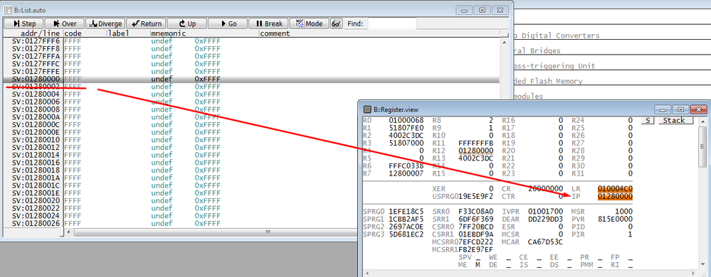

qiaodeng
Hi Peter,
      Before I execute se_blrl :
   And then I execute se_blrl,  what I executed is single step, but the target was running and did not stop.  I have to click the break and read the register:
The instruction pointer is on address 0x1001060.
Qiao

petervlna
Your first screenshot is correct.
Once you execute jump you will end up in address 0x1280000. As you require.
If you have any core on this address I cannot see from screenshots.
So everything works fine.
Peter
5,963 Views
qiaodeng
Hi Peter,
    Thanks for your help. The problem has been solved. I checked the code at address 0x1280000, it was not flashed correctly.
