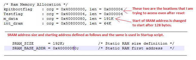

I am trying to retain a RAM value even after reset. But unfortunately the RAM locations are getting reset.
I tried to reserve 128 bytes and tried to store the value in 8 bytes and made that location as NO LOAD. I also altered startup script to initialize the SRAM to start initialize the location after the reserved memory. Nothing helped.
I have attached my Linker file along with Startup script.
Does anyone to how to work with this? Any help is much appreciated.

RAM memory content is lost on following reset assertions:
1. Power on reset
2. Destructive reset
3. Long functional reset with BIST enabled
RAM content is preserved on reset:
1. Short functional reset
2. Long functional reset with BIST disabled
