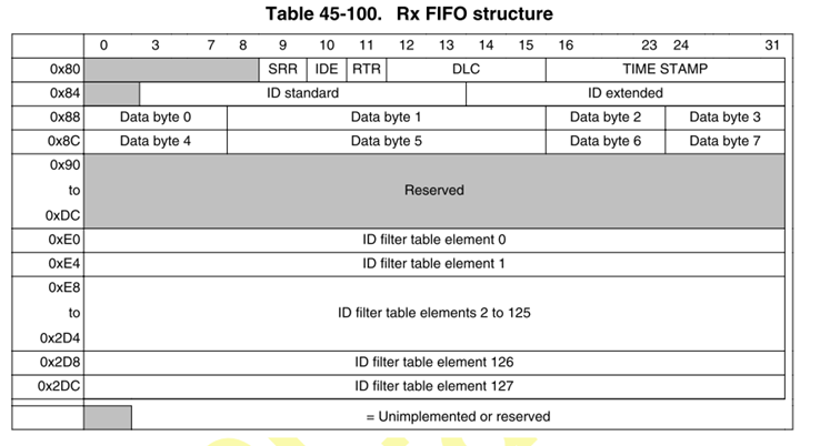

PetrS
Hi Jeff,
Please read chapter 45.3.29 “RX FIFO structure” carefully. Here I am placing just a picture from the RM.
The RXFIFO is 6-message deep. To read the RX FIFO you always use the 0x80-0x8C region, similarly as the MB0 is read.
Before using the FIFO you have to set full ID table as per the length set in CTRL2[RFFN]. Out of reset, the ID filter table flexible memory area defaults to 0xE0 and extends only to 0xFC, which corresponds to MBs 6 to 7 for RFFN = 0. So just 8 ID filters must be written.
Flags are set in following way when FIFO is enabled. The 8 least significant interrupt flags (BUF7I–BUF0I) is changed to support the FIFO operation. BUF7I, BUF6I and BUF5I indicate operating conditions of the FIFO, while BUF4I to BUF0I are not used. In details
- BUF5I - Frames available in FIFO. Once set you should read the MB0
- BUF6I - FIFO Warning. 5 frames have accumulated in the FIFO.
- BUF7I - FIFO Overflow. The FIFO is full and subsequent frames are not accepted until the CPU creates space in the FIFO by reading one or more frames (using MB0 still !!!). While the FIFO is full, the frames are only received if they are matched with another MBs.
BR, Petr

jefferson_ll
Hi Petr,
According to your suggestion, I have read MB0 sequentially under BUF6I asserted.
Unfortunately, I can't read FIFO data sequentially and always get the same data.

PetrS
Well I forgot to highlight one thing, but it is actually stated within the RM.
Each time you read the RXFIFO you need to clear the BUF5I flag so the FIFO output is updated with the next message. So your code could be following to read all 5 messages from FIFO upon BUF6I is set.
