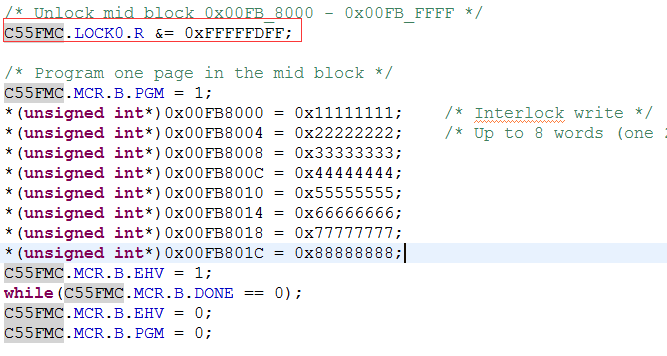

eautopower
look this program:
why the C55FMC.LOCK0.R = 0X00000200 is unlock mid block 0x00FB_8000 - 0x00FB_FFFF?
datasheet no any information.
13,481 Views

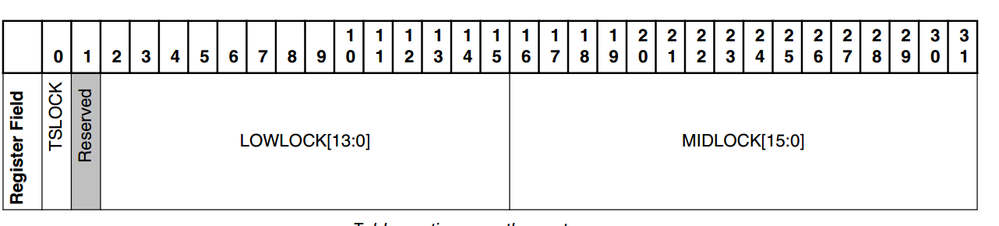

eautopower
Peter:
   i have already see the Documentation,but i still unknow about  Flash block  select .
like:
the datasheet say middle block number  is six:
if i want erase the 0x00FD000-0XFDFFFF block, the MIDSEL[3] =1?
13,481 Views

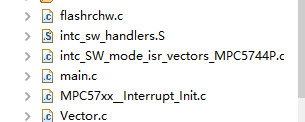

my_souls
There is an official interface to the Flash API.
I do the CAN boot loader, APP is divided into two projects, APP HEX data written to Flash.
13,481 Views

my_souls
http://www.nxp.com/downloads/en/device-drivers/C55_JDP_SSD.exe
Download and extract, there are C55 FLASH manual and demo.
The following is the interrupt vector table sections.ld file.
.intc_vector_table : ALIGN(4096)
*(.intc_vector_table)
} > m_text
You can add an interrupt vector table to the code that links to the flash
Const uint32_t __attribute __ ((section (". Intc_vector_table"))) IntcIsrVectorTable [] = {};
You can then operate on the register.
// Initialize the core IVPR
Xcptn_xmpl ();
// Select software (HVEN = 0) or hardware (HVEN = 1) vector mode
INTC_0.BCR.R = 0x00000000;
// Set the INTC ISR vector table base address.
INTC_0.IACKR0.R = (uint32_t) & IntcIsrVectorTable [0];
These files, the new project will automatically generate this code.
