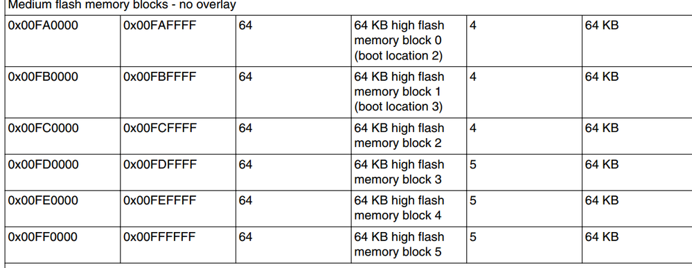

Hi:
   How do I implement FLASH read, write, and erase?
    I read datasheet. Is the address code downloaded to FLASH 0X01000000-0X01FFFFFF?
if i want to do CAN bootloadr, I wrote the application layer in Simulink,How to change the interrupt vector?

eautopower
look this program:
why the C55FMC.LOCK0.R = 0X00000200 is unlock mid block 0x00FB_8000 - 0x00FB_FFFF?
datasheet no any information.

eautopower
Peter:
   i have already see the Documentation,but i still unknow about  Flash block  select .
like:
the datasheet say middle block number  is six:
if i want erase the 0x00FD000-0XFDFFFF block, the MIDSEL[3] =1?
