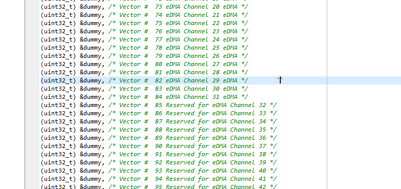

Hi, I have a problem about configuring the PWM switch control code.
In my code, I want to synchronize  PWM with ADC.
So I configured PWM, CTU and ADC.
After that I tried to use ADC_ISR to make the main code  work.
But since I don't know how to use ADC_ISR, I refer the etimer example code.
 Therefore, I made "ADC_ISR  in intc_SW_mode_isr_vectors_MPC5744p.c" file
and put it into "ADC_ISR and ADC_init", but it didn't work.
I will attach the code here. Please help me to work it, if you can.
Thank you so much.

extern void ADC_ISR(void);
/* GLOBAL VARIABLES */
const uint32_t __attribute__ ((section (".intc_vector_table"))) IntcIsrVectorTable[] = {
(uint32_t) &dummy, /* Vector # 496 ADC_EOC ADC_0 */
(uint32_t) &dummy, /* Vector # 497 ADC_ER ADC_0 */
(uint32_t) &dummy, /* Vector # 498 ADC_WD ADC_0 */
(uint32_t) &dummy, /* Vector # 499 Reserved for ADC ADC_0 */
(uint32_t) &ADC_ISR, /* Vector # 500 ADC_EOC ADC_1 */
(uint32_t) &dummy, /* Vector # 501 ADC_ER ADC_1 */
(uint32_t) &dummy, /* Vector # 502 ADC_WD ADC_1 */
(uint32_t) &dummy, /* Vector # 503 Reserved for ADC ADC_1 */
(uint32_t) &dummy, /* Vector # 504 ADC_EOC ADC_2 */
(uint32_t) &dummy, /* Vector # 505 ADC_ER ADC_2 */
(uint32_t) &dummy, /* Vector # 506 ADC_WD ADC_2 */
(uint32_t) &dummy, /* Vector # 507 Reserved for ADC ADC_2 */
(uint32_t) &dummy, /* Vector # 508 ADC_EOC ADC_3 */
(uint32_t) &dummy, /* Vector # 509 ADC_ER ADC_3 */
(uint32_t) &dummy, /* Vector # 510 ADC_WD ADC_3 */

INTC_0.PSR[82].R = 0x01; /* ADC Interrupt priority 8 */

INTC_0.PSR[611].R = 0x8001; //set interrupt priority

petervlna
You are setting priority for vector 82 which is DMA and you have dummy loop there.
Configure priority for vector 500 where you set ISR for ADC1 EOC.
regards,
Peter
