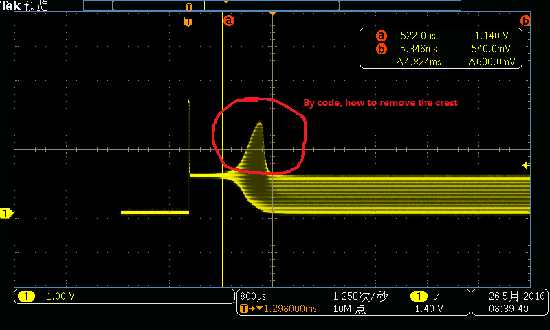

MPC5744,XOSC initialize start-up phase of the waveform problem
Here is the code I use,according to DEMO.
void g_v_MCModeInit(void)
    vuint32_t      temp,timer;
    /* Disable Software Watchdog (SWT) */
    SWT_0.SR.R                        = 0xc520;
    SWT_0.SR.R                      = 0xd928;
    SWT_0.CR.R                      = 0x8000010A;
    /* Clear all "Functional Event Status reset sources" to avoid staying in SAFE mode */
    MC_RGM.DES.R = 0xFFFFFFFF;               //write 1 to clear dest reset events
    MC_RGM.FES.R = 0xFFFFFFFF;               //write 1 to clear func reset events
    MC_ME.ME.R = 0x000005FF;    //enable all modes
    XOSC.CTL.B.OSCM = 0x1;       //Without this code, the start-up phase of the waveform more unstable
   XOSC.CTL.B.EOCV = 0x80;        //This code with or without observation oscilloscope waveforms found no effect
    // Enable the EXTAL clk
    MC_ME.DRUN_MC.B.XOSCON=1;
    /* RE enter the drun mode, to update the configuration */
    MC_ME.MCTL.R = 0x30005AF0;                       /* Mode & Key */
    MC_ME.MCTL.R = 0x3000A50F;                /* Mode & Key inverted */
    while(MC_ME.GS.B.S_MTRANS == 1);                /* Wait for mode entry to complete */
    while(MC_ME.GS.B.S_CURRENT_MODE != 0x3);       /* Check DRUN mode has been entered */
    /* Wait for clock to stabilize */
    while(!MC_ME.GS.B.S_XOSC);

Any body help me?

davidtosenovjan
I have assigned similar question from different customer, now waiting for factory response. However it seems it is common behavior of this device.
