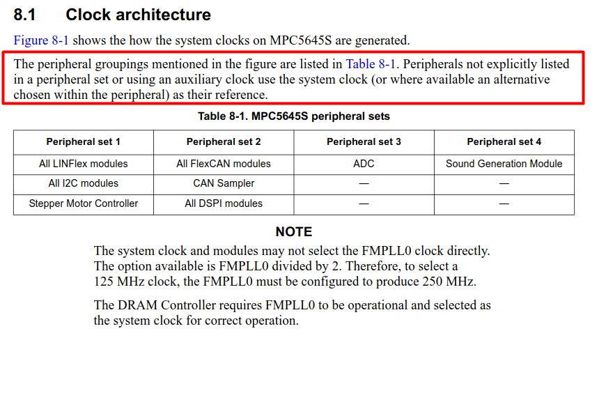

About MPC5645S PIT clock source.
I configured RUN0, PIT use RUN0. My System clock is 100MHZ.
But where can I find what is PIT clock source? in mannual it is said peripheral bus clock.
Is it 100MHz?
1,787 Views
davidtosenovjan
Hi, according to following description, it should be "system clock":
1,787 Views
ino0
Thanks!
