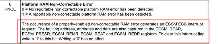

I have a problem with testing SRAM ECC in the MPC5644A. I'm using ECSM.EEGR.FR1NCI to generate a single 2-bit data inversion. This seems to work so far, as ECSM.ESR.RNCE is being set. Also, I have set ECM.ECR.ERNCR to enable non-correctable error handling.
What does not work is that an interrupt for vector number 9 (page 355 in the reference manual) is triggered. I have an ISR assigned in my interrupt vector table and assigned INTC.PSR[9].B.PRI   = 0x06U;
What am I missing? Any hints are highly appreciated.

Ok, so I was talking with colleague more experienced with this old device ECCs.
First is called IVOR1 on the error injection. As it have higher priority.
Only after it is called IVOR4 if enabled.
Please have a look at AN5200, you can use example for MPC5643L as they have identical ECSM and error handling.
https://www.nxp.com/docs/en/application-note/AN5200.pdf
http://www.nxp.com/files/microcontrollers/doc/app_note/AN5200SW.zip
Peter

Hey Peter,
thank you so much! AN5200 chapter 3.2 was the missing link for me. In the end my IVOR1 handler wasn't correctly implemented.
