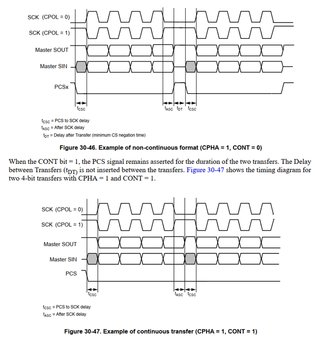

I have a question regarding the DSPI controller in the MPC5644A. I would like to configure a delay between the assertion of the chipselect and the first edge of SCK. When changing CSSCK[0:3] to something >0 I do indeed see a delay between the assertion of PCS and the first edge of SCK. But the same delay is now also present between each 8bit frame! Same goes for ASC[0:3].
Any ideas on what I might be missing? Or is this intended behaviour?

tCSC will be the always as you can see on the screenshot below:
8,377 Views
davidtosenovjan
Yes, it is correct behavior, all these times are supposed to be there. The only time disappearing between frames in case continuous transfer, it is tDT.

From the RM, chapter 30.9.5.2:
"The PCS to SCK delay is the length of time from assertion of the PCS signal to the first SCK edge."
CS is asserted the entire time..
