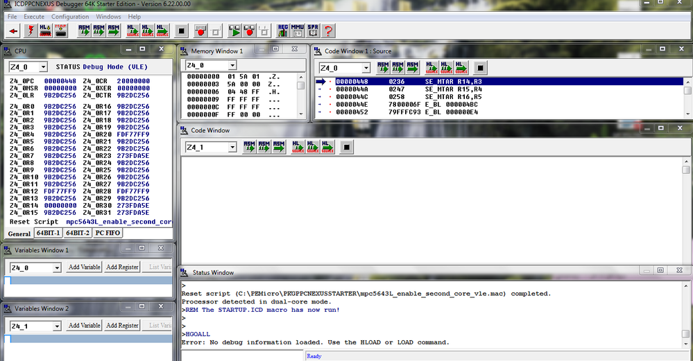

   Upon power ON, and debugger connect, the reset script of the PE micro runs and i get the below window (pointer is  at address 0x448), where the controller is detected in DPM mode and the selected macro has run. Now when i run the software, it says "No Information Loaded".   Core 0 status shows as in debug mode and core 1 status is at reset.
If you do not mind, could you please tell me the step by step procedure you did to flash my program and test in your micro. I feel i am missing something while flashing the software.

Core0 running and core1 in reset is correct behavior after reset.
Is your code running in standalone mode? (without debugger)

This is what i observe on reset,
I used the reset script algorithm from PE.

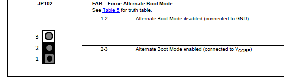

Are you in internal boot mode?
make sure that FAB is set to 0.
Peter
4,242件の閲覧回数
subashr
   I have the FAB at 0 only. I have shorted the 1-2 pin of the jumper according to the below picture.
