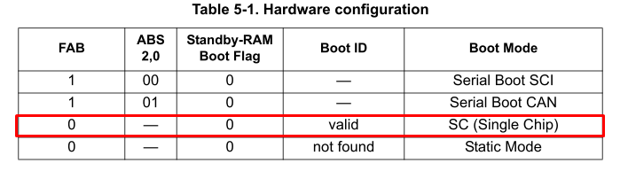

I am currently working with Development board KT33908MB with KTMPC5643DB (mother board and daughter board). I am trying to create a base code to switch on the led's on the mother board , operating the controller in LSM and DPM mode. I used "CW for MPC55xx and MPC56xx 2.10" to generate a code for DPM and LSM separately. In the DPM project, i configured the ports and wrote a simple code to toggle the led.
I flashed my DPM project and could see the led toggling with both the cores running. But once I reset the board, the software doesn't run. Again I have to flash the project to see the same output.
What is the startup sequence that i need to follow to have a proper boot and software run on every power cycle (without the debugger)

petervlna
It looks correct. Your start address is 0x448 for this program. after reset you must always start here.

subashr
   Upon power ON, and debugger connect, the reset script of the PE micro runs and i get the below window (pointer is  at address 0x448), where the controller is detected in DPM mode and the selected macro has run. Now when i run the software, it says "No Information Loaded".   Core 0 status shows as in debug mode and core 1 status is at reset.
If you do not mind, could you please tell me the step by step procedure you did to flash my program and test in your micro. I feel i am missing something while flashing the software.

petervlna
Ok, and what address do you see right after reset from debugger?
is it 0xFFFFxxxx - BAM area?
Because I am able to run your code here on my micro without issues. You should be on address 0x37C.
Is your micro in DPM mode?

petervlna
I have tested your code.
It is working as expected. After reset program starts at __start label.
Are you in internal boot mode?
make sure that FAB is set to 0.

subashr
   I have the FAB at 0 only. I have shorted the 1-2 pin of the jumper according to the below picture.
