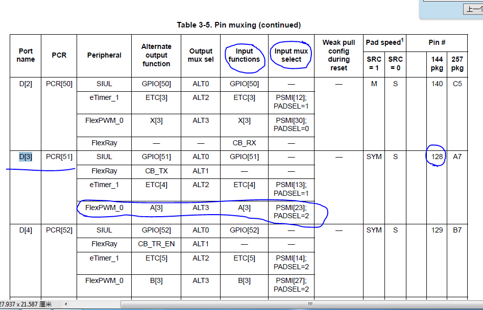

Hi sir,
      I am a new to use  the function of FlexPWM capture about  MPC5643L. In  the process of using, I had a promblem.
      I use the PIN of D3 (A[3]) as the input port to capture the signal,but every time signal capture faild. I have  already achieced capture  use the x[n]. who knows what is the difference between capture A/B[n]  and capture  x[n] .Thank you can  provide source code and some information.
In the chip reference manual pin function table, I discover that  this pin has a capture function. The following is a screenshot of my list from the chip reference manual .
The chip reference manual shows that flexPWM_0 about A [3] has a capture function. Now I do not know how to do it.
thank you very much for your help.

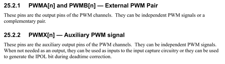

Hi Tomas,
Yes, the Table 3-5 shows input functions for A and B pins and there could be this options in SIUL module.
However the input capture feature is not implemented on A and B pins on the MPC5643L’s FlexPWM module. And there is no control registers for capture feature on PWMA[n] and PWMB[n].
Only the PWM[X] can be used for this feature and capture control registers are available for PWM[X] pin.
