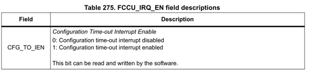

We are developing a system in which we need to log alarms and faults generated by the FCCU on the MPC5643L.  To test this I am Injecting fake critical and non-critical faults, critical faults should generate an NMI which we have attached a logging function to, and the interrupt controller has a handler assigned to 250 which should catch the alarm interrupts. This code has previously worked and I managed to record alarm codes to shadow flash, however neither of these handlers are now being called.  I know that the critical fault injection is still functioning as it generates a RESET and transition to SAFE mode but there is no response to the non-critical fault injection.
Is there any way in which the interrupts could be disabled?  The register FCCU.IRQ_EN only has a single field for the Configuration Time Out interrupt.

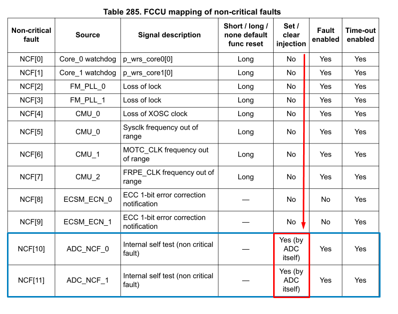

If you take a look at table Table 285. FCCU mapping of non-critical faults in reference manual you will see:
Under Set/clear injection (inject fault) - the faults which can be injected. For ADC self-test (NCF10 & NCF11) it is [Yes - by ADC itself)]
This means NCF 10 and 11 can be injected onyl by ADC peripheral.

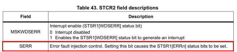

If you take a look on ADC self-test registers: Table 43. STCR2 field descriptions
So, for injection of this particular fault you need to set ADC.STCR2[SERR] = 1. Then you will see it in FCCU.NCF_S register.

[Peter] - In FCCU NCF Enable Register you can mask the reaction following a fake non-critical fault.
FCCU NCFS Configuration Register (FCCU_NCFS_CFG0..7) the reaction on fault. As you didn’t share your FCCU configuration, please make sure you have your FCCU configured properly.
[Peter] – Yes, even whole reaction can be disabled via FCCU configuration registers.
The external interrupt is asserted if any interrupt status bit of the FCCU_IRQ_STAT is set and the respective enable bit of the FCCU_IRQ_EN register is also set.
The register FCCU.IRQ_EN only has a single field for the Configuration Time Out interrupt. The non-critical fault I am testing is enabled and has a timeout enabled so the FCCU should transition to the ALARM state.
[Peter] – Yes, it should on timeout trigger and interrupt
[Peter] - To avoid any speculations, I would like to see your FCCU configuration.

Your FCCU configuration seems fine to me. Except one thing, you need to enable interrupt on Timeout.
Also do not forget to enable interrupts in INTC
And to enable external interrupts in MSR[EE]=1

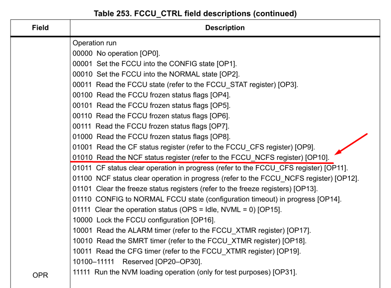

petervlna
After injecting of NCF, are you reading NCF_S registger correctly like described below?
The SW application executes the FCCU_NCFSx read operation by the following sequence:
• to set the OP10 operation into the FCCU_CTRL.OPR field
• to wait for the completion of the operation (FCCU_CTRL.OPS field)
• to read the FCCU_NCFSx register
6,301 Views
twp
Hi Peter,
Yes, I am following that procedure.  It correctly reads the fault status register values if I generate an ADC self-test failure.  The whole interrupt and logging code works if it is a system generated fault but not if I inject a fault.
If you need any further help do not hesitate to ask.

Thanks Peter,  I had missed the meaning of that column in the table.

"Does the FCCU need to in a particular state or be sent an OP code before a fault can be injected?"
FCCU can inject faults in Normal state.
First please make sure that your FCCU sw routine is injecting NCF correctly. Inject the fault and read  FCCU NCF Status Register to verify that fault was recorded in  FCCU NCF Status Register.
You need to set OP10 [01010 Read the NCF status register (refer to the FCCU_NCFS register) [OP10].] to properly read the status.
