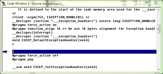

sufree
Hello ,
I face the question as follow:when debugging ,when run :
/* step2. program data */
CFLASH0.MCR.B.PGM = 1; // select operation
*((unsigned int*) 0x00038928) = 0x66AA66AA; // first write
*((unsigned int*) 0x00038928+0x4) = 0x11BB11BB; // additional write
 the program break and into :QQ图片20160904211500.png
I need some about it,Thanks.
6,285 Views
lukaszadrapa
where the code is running from? Read-While-Write is supported only between banks, so you are not allowed to access bank which is currently being erased or programmed. Address 0x0003_8928 belongs to bank 0, so the code must run from bank 1 (high address space) or from RAM.
Lukas

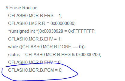

lukaszadrapa
there's a typo:
You have to clear ERS bit. Then it will work.

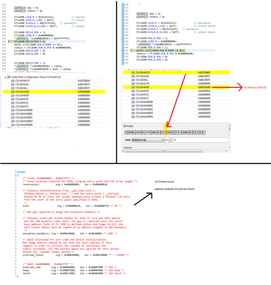

buraksoner
Hello Lukas,
Thanks for pointing the typo out. But that seems to be irrelevant to my problem. The code gets stuck in the "while" before that line. I've realized something more about this: I think I get stuck in that while (erase is not done) because after setting the EHV bit I get a read while write error (I've seen this at the MCR register). Please see screenshot below:
I don't have any other interrupts etc. running in the background though. This function is called in main after the watchdog disable and PLL init so there should be no interrupts/flashreads that I've
Is there maybe a configuration problem in this?
Burak
6,286 Views
lukaszadrapa
Where the code is running from? Read-While-Write is supported only between banks. We should not access flash bank during erase/program operation. So, the code should be executed from RAM or from another bank. I guess this is the reason.
The code itself works fine on my side.
Lukas
