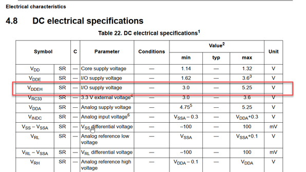

hi
i want to know work voltage of GPIO122/134/120/123/124. Are they 5V? What is the fluctuation range of the work voltage? What's the rated operational current?
Thanks so much.
1,106 Views
davidtosenovjan
Voltage level are derived from power supply rail associated to the pad. In this case if can be both nominal 3.3V or 5V.
Operating currents are also defined in Table 22. DC electrical specifications
