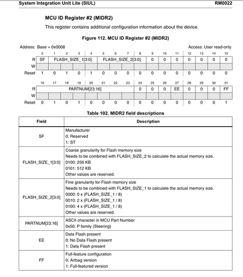

The chip I am using is MPC5604P, please how can I do it to get the chip ID?
3 返答(返信)
1,735件の閲覧回数
petervlna
You can read it in MIDR registers or SIUL:
