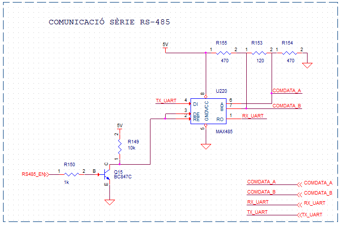

xuuurraa
I am not using a board, I have my own design, I´m using a SPC5604PGVQ6 connected to communication RS-485. The microcontroller is connected to PC with a USB-RS485, or sometimes connected to another microcontroller, now I am trying communication between two microcontrollers. In old codes I tried to read with software request and works fine, but I would like do it with an interruption. If you want more details please feel free to ask me back.

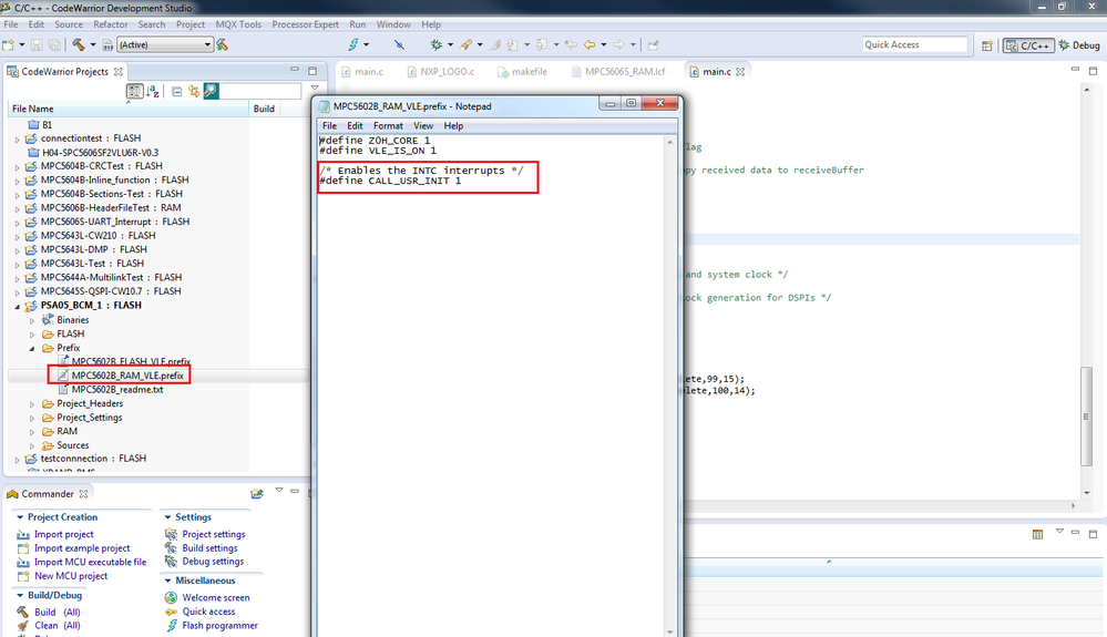

martin_kovar
the information about software request is very important for me. Which target you use RAM or FLASH?
If you use RAM target, you have to define following macro to the RAM.prefix file place in Prefix folder in your project:
#define CALL_USR_INIT 1
Martin
4,340 Views
xuuurraa
Thank you very very much. WORKS!!!
