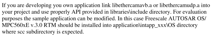

The thing is: even though the demo is working at the moment, I'd like to begin an add my own code to the dev-kit. I therefore bought a P&E Microlink Universal and downloaded the Evaluation version of Codewarrior for Qorriva and Codewarrior Classic fpr MPC5xxx. I assume, that the source-files from the Post Programm MPC5604EKIT  are the correct ones to begin development.
Unfortunately, I'm not able to import the provided .mcp file into Codewarrior (Eclipse). While importing the Wizard states: "This toolchain is not supported for this target". I'm intrigued by this error since I downloaded the version of CodeWarrior which is supposed to support the MPC5604E. (When I create a project from scratch, I'm able to select my target MCu and Debugger correctly)
While trying the same project file with the classic IDE, it opens the project without error but states to not being able to find several header-files, which are not present in the downloaded package for example os.h. This has great similarity to the Error which posted in his thread MPC5604EKit EvaluationBoard Software but didn't receive an answer...

yes, the application is written in classic version of CodeWarrior.
Document SalsaLowCostRefKitLibAPI.pdf included in the package says:
Autosar OS is commercial software, it is not provided for free:
Freescale AUTOSAR Software Solutions|Freescale
Please contact your local automotive sales representative for details on pricing and ordering.

thanks for your answer. Since the investment in Autosar has to be discussed with my superiors first, I'm currently trying to load any other code onto the evaluation board am experiencing strange errors.
When I try to set up a new project (as simple as you can imagine) in Codewarrior (Eclipse), the IDE prompts wont allow debugging, it prompts the Dialog "Password required: Device may be censored. Please enter password (in hex) to uncensor) and then crashes.
In codewarrior Classic, the IDE crashes when I try to initialize a debug-session..
I'm not sure if the MCU is indeed censored (maybe you know more about this) or if my debug-Hardware is malfunctioning. I'm using a P&E Multilink universal.

Nevermind, in the meantime I found out, that it was indeed a problem with the USB driver. I'm up and running my own code from RAM.
