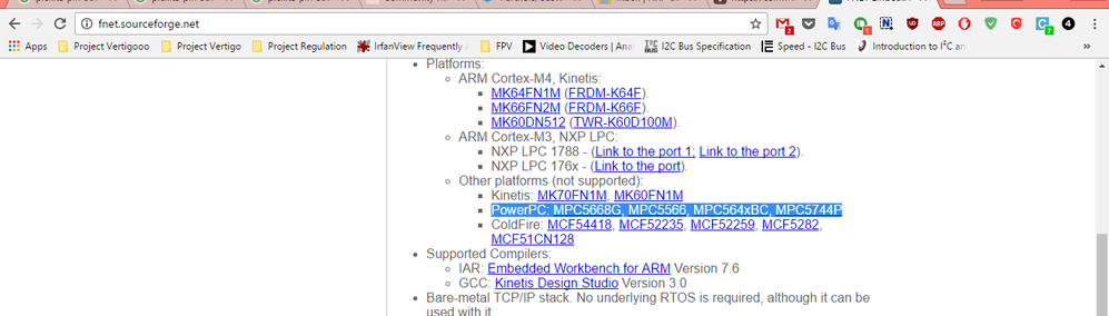

I'm working on MPC5604E and using its Fast Ethernet Controller[FEC], How to initialize fNET stack on the controller ?

please look at the following app note. There is good description of TCP/IP stack. App note is written for MPC5644B, but it is also usable for MPC5604E, because FEC module is the same.
http://cache.nxp.com/files/32bit/doc/app_note/AN4577.pdf?fsrch=1&sr=1&pageNum=1
There are also software examples for this app note:
http://cache.nxp.com/files/32bit/doc/app_note/AN4577SW.zip

But according to "FNET Embedded TCP/IP Stack", MPC5604E is not supported. [Refer the attached Image]fnet.PNG
