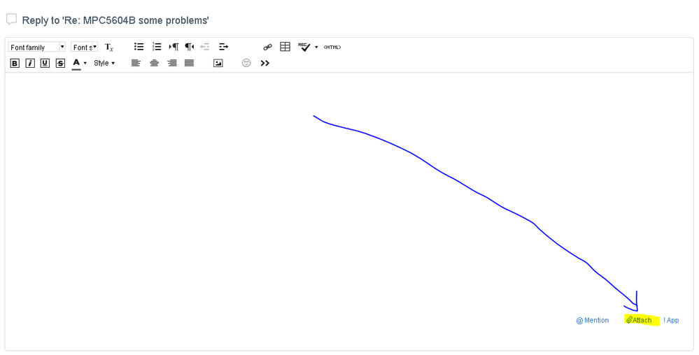

hanxl
      I didn't find the attachment。

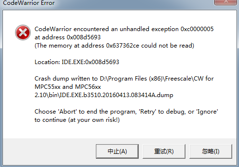

    4.My CodeWarrior often Popup window
The Following is the content of file IDE.EXE.b3510.20160413.083414A.dump:
Crash report for D:\Program Files (x86)\Freescale\CW for MPC55xx and MPC56xx 2.10\bin\IDE.EXE (.20160413.083414A)
Unhandled exception 0xc0000005 caught at 0x008d5693
(The memory at address 0x637362ce could not be read.)
IDE Version: 5.9.0 Build 3510
OS Version: Professional  (6.1.7600)
Product info:
CodeWarrior Development Studio for Freescale MPC55xx and MPC56xx version 2.10, build 120305.
Please send this crash report to <[email protected]>, along
with a brief description of the operations leading up to the crash.
