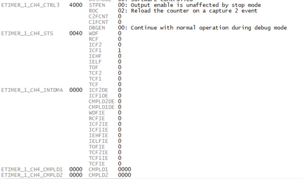

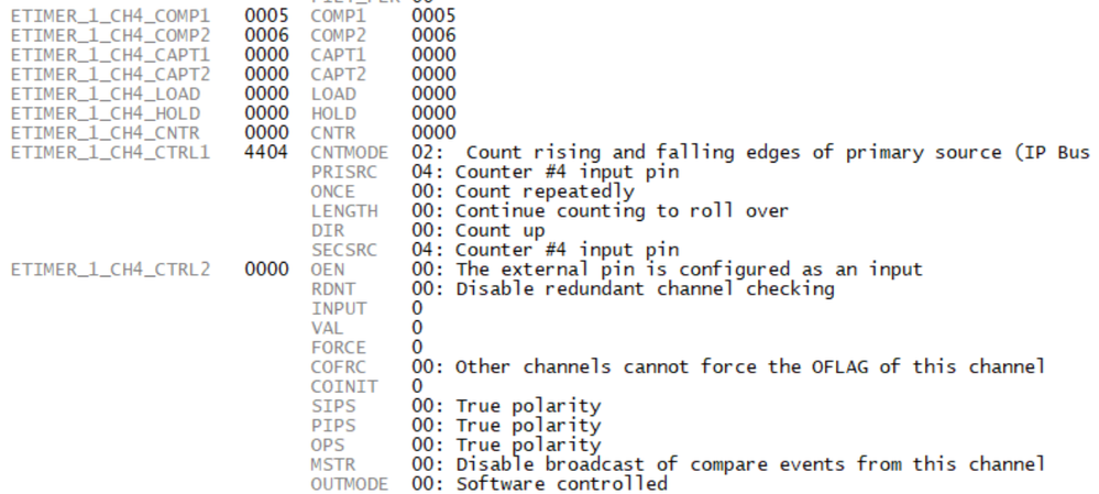

when using mpc5574 ic(144pin) etimer module, configuration as pictures shows above, I want to count rising edge of the input signal, but it seems that the count regs did not work at all(always equals 0). I want to know if the configuration about etimer is right? rtimer1 ch4 is selected, and input 4 pin is SECSRC , input field of control2 register changes between 0 and 1. PRISRC was first configured as IP Bus clock divide by 2 prescaler(11001), now configured  input 4 pin,  to ensure edge exist.
        I want to know why the counter don't work.
        Thank u in advance.

check if channel is enabled in ENBL register.
Also be sure the pin is properly configured to be routed to eTimer Ch4.
Specify the MCU you have, MPC5574 must be typo.
BR, Petr

yun_qiu
Hi Petr,
   I am sure channel is enabled in ENBL register, because I enabled all six channels of eTimer 1.
   MPC type is 5744, wrong type.
   PWM Input from D8 pin, and it is configured to eTimer 1 channel 4. Checked. But it still doesn't work.
   Registers configuration code as follows:
#define ETIMER_1_CHANNEL_4_CONFIG \
       (               ETIMER_Set_Device_Index(0, ETIMER_DEVICE_INDEX_1                  ) | \
                            ETIMER_Set_Channel(0, ETIMER_CHANNEL_4                       ) | \
                  ETIMER_Set_Channel_Direction(0, ETIMER_CHANNEL_INPUT                   ) | \
     ETIMER_Set_Co_Channel_Force_Output_Signal(0, ETIMER_OTHER_CH_FORCE_OFLAG_DISABLE    ) | \
          ETIMER_Set_Co_Channel_Initialization(0, ETIMER_OTHER_CH_FORCE_REINIT_DISABLE   ) | \
   ETIMER_Set_Secondary_Channel_Input_Polarity(0, ETIMER_TRUE_POLARITY                   ) | \
     ETIMER_Set_Primary_Channel_Input_Polarity(0, ETIMER_TRUE_POLARITY                   ) | \
             ETIMER_Set_Output_Signal_Polarity(0, ETIMER_TRUE_POLARITY                   ) | \
                        ETIMER_Set_Output_Mode(0, ETIMER_OFLAG_SOFTWARE_CONTROLLED       ) | \
                  ETIMER_Set_Reload_On_Capture(0, ETIMER_NO_RELOAD_ON_CAPTURE            ) | \
                       ETIMER_Set_Compare_Mode(0, ETIMER_COMP1_COUNT_UP_COMP2_DOWN         ) | \
             ETIMER_Set_Capture_2_Mode_Control(0, ETIMER_CAPTURE_FALLING_EDGES           ) | \
             ETIMER_Set_Capture_1_Mode_Control(0, ETIMER_CAPTURE_RISING_EDGES            ) | \
             ETIMER_Set_Capture_FIFO_Watermark(0, ETIMER_CAPTURE_FIFO_2                  ) | \
              ETIMER_Set_One_Shot_Capture_Mode(0, ETIMER_FREE_RUNNING_MODE_CAPTURE       ) | \
               ETIMER_Set_Input_Capture_Enable(0, ETIMER_INPUT_CAPTURE_ENABLE            ) | \
                  ETIMER_Set_Compare_2_PreLoad(0, ETIMER_COMPARE_NO_PRELOAD2             ) | \
                  ETIMER_Set_Compare_1_PreLoad(0, ETIMER_COMPARE_NO_PRELOAD1             ) | \
          ETIMER_Set_Input_Filter_Sample_Count(0, ETIMER_FILTER_3_SAMPLES                ) | \
                     ETIMER_Set_Capture_Select(0, ETIMER_CAPTURE1_REGISTER_ENABLED  ) )
#define ETIMER_1_COUNTER_CHANNEL_4 \
            ETIMER_Set_Count_Mode(0, ETIMER_COUNT_RISING_EDGE_PRIMARY_SOURCE) | \
            ETIMER_Set_Primary_Source(0, ETIMER_PRIMARY_COUNTER_IP_BUS_DIV_2  ) | \
            ETIMER_Set_Count_Once(0, ETIMER_COUNT_REPEATEDLY                ) | \
            ETIMER_Set_Count_Length(0, ETIMER_COUNT_TO_ROLL_OVER              ) | \
            ETIMER_Set_Count_Direction(0, ETIMER_COUNT_UP                        ) | \
            ETIMER_Set_Secondary_Source(0, ETIMER_SECONDARY_COUNTER_4_INPUT_PIN   ) )
        Is there anything wrong?
