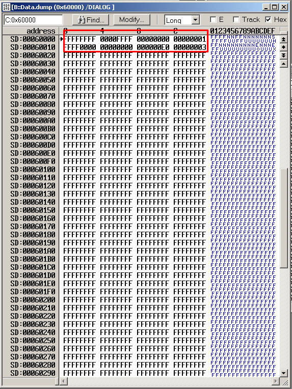

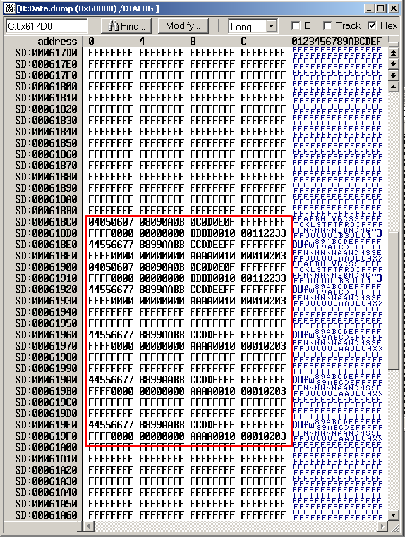

I am working on MPC5554. And I use eeprom emulation functions. I fill all of the flash block. Then I want to erase block(address: 0x60000) on flash, but after erase, some other datas (except 0xFFFFFFFF) can be random in block. After erase, yes most of the flash area are 0xFFFFFFFF but some area can be random data. And FSL_FlashCheckStatus() functions return EE_OK after erasing. how that happens? And why some area don't erase?
The following images are taken after deleting the flash block.

the most common reason for such behavior is cache memory. The cache memory should be disabled or the areas used for EEE should be configured as cache inhibited (using MMU) or it's necessary to invalidate the cache after erase operation.
The fastest way to confirm that it is caused by cache is to set CINV bit in core register L1CSR0 via debugger. This will invalidate the cache and you should see that erased blocks are '0xFFFF' only...

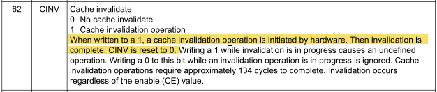

I could not set CINV bit. I dont know why am I could not set CINV bit via debugger? but I set/clear CE bit in the same register. And it works. Thank you your interest.
4,913 Views
lukaszadrapa
this is expected behavior:
Because the invalidation takes about 134 cycles, it looks like the bit is still 0.
