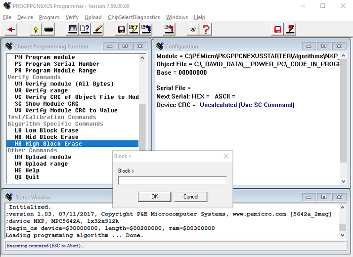

I want to download two different projects(like APP 1 and APP 2) into the internal FLASH.
But when I use the CPROGPPCZ Programmer, it always erase the whole FLASH!
So, I want to know how to download APP 2  into  the FLASH without erasing APP 1.
3,541 Views
davidtosenovjan
I see. It is needed to use programmer that is capable to erase each block individually as in the screenshot below:
3,538 Views
Shenovy
Thanks first, I've tried this way before.
However, if I only erase one block, I can't programm the object file. It reminds me that I have to execute  the EM(erase module) command as in the figure below.无标题.jpg无标题.jpg
