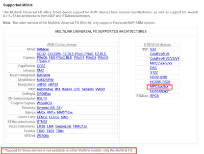

hi, i have one MPC555 and P&E Multilink Universal on hand. what i want to know is if the Multilink Universal version can support the debug for MPC555.
if yes, which connector can we use?
Or we must use Multilink FX version?
where can we get related docs?

Hi Harry,
the screenshot below comes from http://www.pemicro.com/products/product_viewDetails.cfm?product_id=15320143&productTab=1
So, the FX version is the only option. In the past, there was this version but it's already discontinued:
http://www.pemicro.com/products/product_viewDetails.cfm?product_id=164&productTab=1
Lukas
