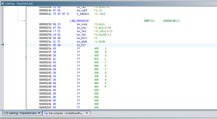

Hello, I have a similar issue - FlashInit for VLE (from Standard Software C90LC Driver v1.0.4/xPC567xK_C90LC/driver/vle/s-record_driver) has se_blr instruction at the end:
Screenshot from 2024-02-05 01-40-41.pngScreenshot from 2024-02-05 01-40-41.png
What is the best way to handle this?

I have already met this problem. See the text below that I wrote some time ago. It refers to e200z0 but it doesn't matter:
The code shown below is at the end of all flash driver functions:
if (pSSDConfig->BDMEnable)
     #ifdef VLE_ASM
          asm ( "se_sc " ); /* generate system call interrupt */
     #else
          asm ( "sc " );
     #endif
The "se_sc" causes the e200z0 core to take IVOR8 interrupt. For external debug tools - flash programming routines, the "se_sc" can be replaced by all zeroes instruction opcodes (se_illegal or bkpt = all binary zeroes psedo-insturction). So, replace the "se_sc" instruction near the end of the function with the "0x0000" or alternatively, initialize IVPR and IVOR8 registers to point to a location in the SRAM where you have 0x0000. Actually, IVOR8 on e200z0h is fixed to 0x80, so initialize the IVPR in such a way that at the address (IVPR || 0x080) there is the all zeroes instruction opcode. In external debug mode, execution of 0x0000 opcode causes the MCU to enter Debug Mode. (OCR[FDB] must be set and DBCR0[EDM] must be set). Refer to 8.4.7.5 in the e200z0 Power Architecture Core Reference Manual. Another option is to configure instruction breakpoint at address (IVPR || 0x080). This will also cause the core to enter Debug Mode upon execution of "se_sc".
Notice that se_sc (or sc) is not the last instruction in C-array. Actually the C code at the end of FlashInit looks like this: …
     { //asm ( "mr r3,returnCode" ); /* save the return code to R3 */
     #ifdef VLE_ASM
     #else
          asm ( "sc " );
     #endif } return
     returnCode;
If I disassemble this code (I simply put the code into new CodeWarrior project) then it gives this result:
00000020: 0002 se_sc
00000022: 481F se_li r31,1
00000024: 01F3 se_mr r3,r31
00000026: 51810014 e_lwz r12,20(rsp)
0000002A: 7D8FF120 mtcrf 0xff,r12
0000002E: C7F1 se_lwz r31,28(rsp)
00000030: C6E1 se_lwz r30,24(rsp)
00000032: C901 se_lwz r0,36(rsp)
00000034: 0090 se_mtlr r0
00000036: 21F1 se_addi rsp,0x0020
00000038: 0004 se_blr
So, the position of "0002" is a few words before the end of c-array.
Hope this will help.
Lukas
