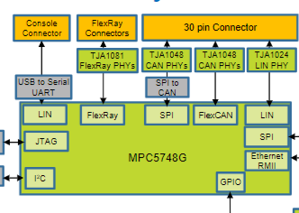

Hi I am working with MPC-LS-VNP-RDB, and I want to configure more than one CAN channel, to receive and send frames, even CAN FD frames.
I have seen the example in S32DS for Power Architecture however I have not seen the possibility of controlling all the CAN inputs, there are 12.
Thanks.

PetrS
the board User Manual (https://www.nxp.com/webapp/Download?colCode=MPC-LS-VNP-RD-UM) shows the CAN interface block diagram. You can use that (or board schematic) to know how CAN transceivers are connected to each FlexCAN modules. You can reuse S32DS examples to init desired FlexCAN modules and thus use more CAN buses.
Besides 8 FlexCAN modules, there are four standalone CAN controllers (MCP2515, SPI to CAN) available to extend above direct CAN solution. However I am not aware there is any demo for MCP2515 usage. You can use demo/driver for DSPI from S32DS but you need to write communication protocol for this device by yourself. Or maybe there's general C driver - you can check with manufacturer of this part.
