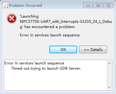

problem :
question:

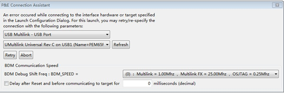

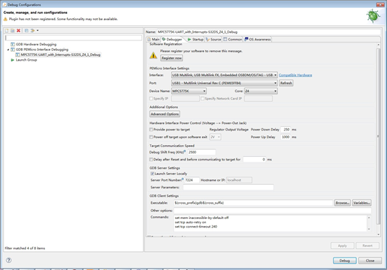

How to configure BDM debug shift freq: BDM_SPEED ?
Tags (2)

which version of S32DS you use? Version 1.0 or v 1.1?
Were you asked about password? If yes, you have to enter DEAD_DEED_FADE_BADE instead of FEED_FACE_CAFE_BEEF.
Martin
2,021 Views
dengwei
Thank you for your support!
Version is v1.1
The problem is solved.
