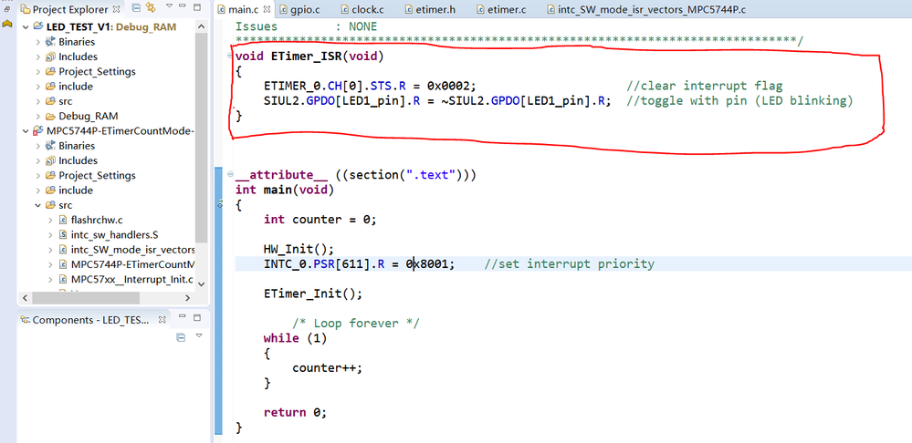

Hello, when I use DEVKIT-MPC5744P, NXP official ETIMER routine on the ETimer_ISR interrupt function call, the main function of the main program does not directly call the ETimer_ISR function, how to achieve LED flashing? (I couldn't copy the routine function into the project I created.)

Hello, I am using this routine, that is, etimer initialization starts the interrupt, how is the interrupt into the interrupt function? Is there a callback function in the interrupt or something else, I just have a question here.
4,694 Views
petervlna
Well, that is not eTimer initialization function. That it interrupt service routine where you clear eTimer interrupt flag and toggle the pin state where is some LED connected.
Simply refer to reference manual INTC chapter for details:
In short:
1. eTimer interrupt flag is set
2. IVOR4 exception handler is called if priority is set in INTC for such interrupt.
3. In IVOR4 there is jump to address (offset set interrupt vector table) of ISR
First read trough reference manual, then check examples. If you need drivers, you can use autosar ones.
Peter
