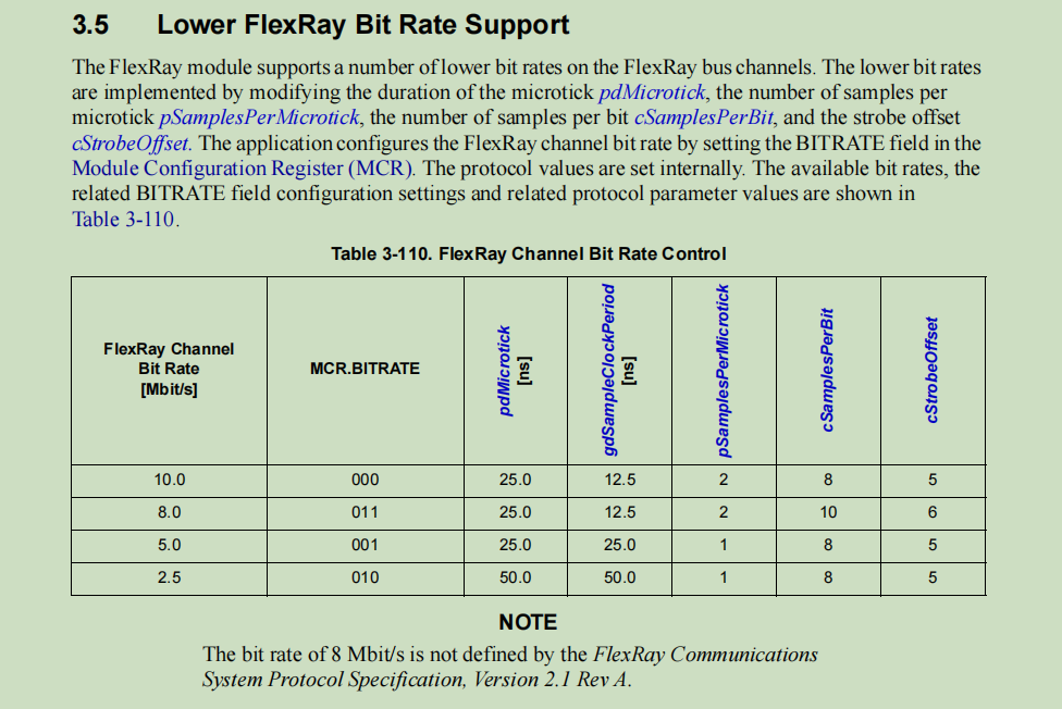

Dear Sir/Madam,
Hope you are well.
Recently, when I used MFR4310 to debug flexray for communication between two nodes, according to the reference manual, the minimum support is 2.0Mbps. The reference manual needs to change the baud rate field in the mode configuration register and some sampling parameterspdMicrotick,pSamplesPerMicrotick,cSamplesPerBit,cStrobeOffset), but I was confused about the modification of the following parameters. I checked all protocol registers, but no corresponding modification was found. Please also help to see how to modify these parameters?
I am looking forward to hearing from you.
Kind regards,
Ms Zhang
