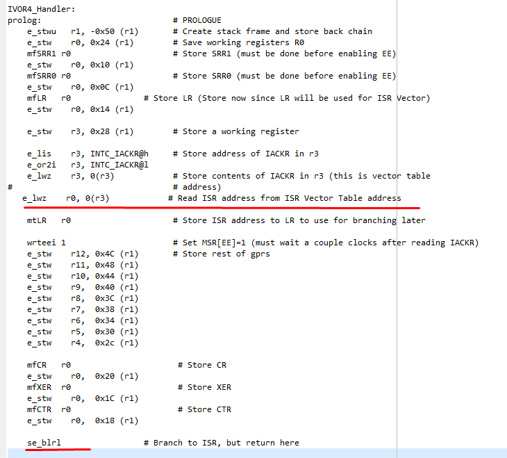

haoxue1027
Contributor V
Hello, petervlna
Now  I am reading the MPC5744P demo  pit_periodic_interrupt_mpc5744p  in the S32.
There is an interrupt handler here like following figure. but I can find where the PIT_Ch0_IRQHandler is defined.
I also cannot find the VectorTable about it.
Can you tell me how to call the function  PIT_Ch0_IRQHandler when the interrupt occurs  ?
thank you very much.
best  regards
hao
