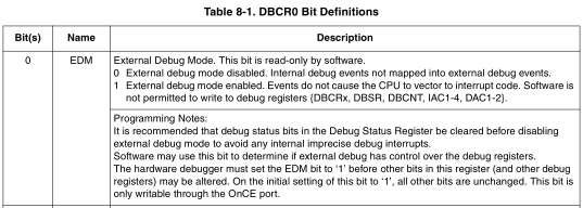

I want to use the debug interrupt without halt.
I am using the SPC5604p.

1. Core Register -> Debug Facilities -> IAC1 : I filled in the address I wanted.
2. Core Register -> Debug Facilities -> DBCR0[IDM] Enable.
    Core Register -> Debug Facilities -> DBCR0[IAC1] Enable.
result:
Core Register -> Debug Facilities -> DBSR[IAC1] : yes.
and halt.
How can i use debug interrupt without halt?

disconnect the debugger / disable external debug mode. This should help.
For debugging of debug interrupt, debugger cannot be used. Instead of that, use rather UART messages or LED toggling or something like that.
